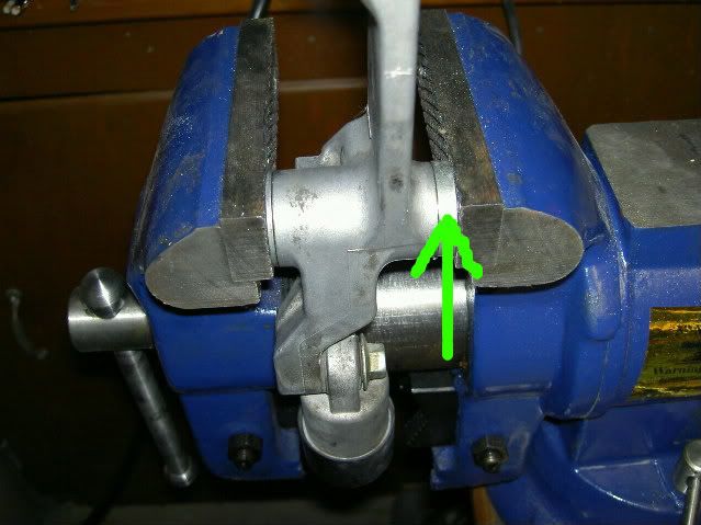

Remove the pulley and set it aside. Now attack the fulcrum pin by placing in a vice and knocking off the washer on the pulley side of the tensioner. This is actually quite easy not much force required at all just use a small screwdriver to get the edge up and it pops right off.

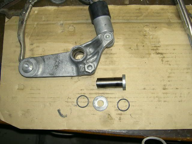

Now pull the pin out the back and also pull the o-ring out of the front and the back. It should look like this when you are done.
Clean the pin and the bore with some solvent then use some grease to lube the bore and the pin making sure to lube the shoulder also. A little grease goes a long way here.

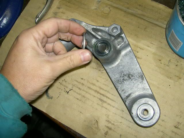

Replace the o-ring in the bore opposite the pulley side and then push the fulcrum pin in. Put the other o-ring in the front side then lube the shoulder with a little grease and put the washer back on.
Now we need to press the washer back on so just place it in the vice and press it back on, once again this does not take much force. Make sure the thick part of the fulcrum washer is facing the engine side of the motor and you have it correct.

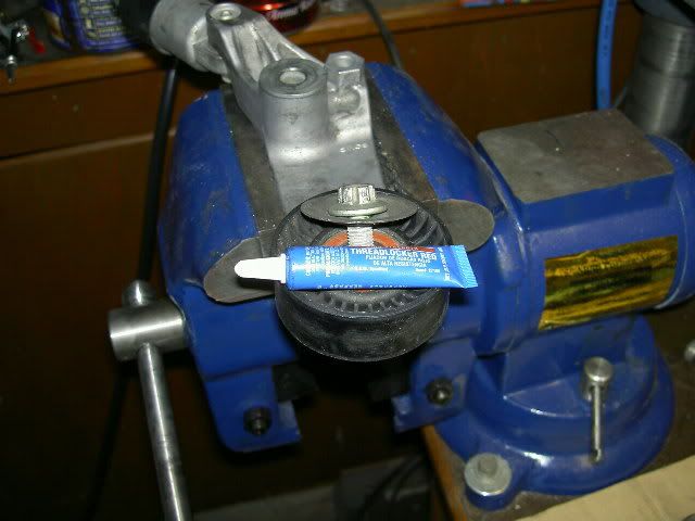

Next up is the new pulley. NAPA part number 38018 (14 dollars) or equivalent.
Loctite the threads and put the new pulley on with the vice grips or you can get a new bolt with a regular head, I just use the funky one and tighten it down good.

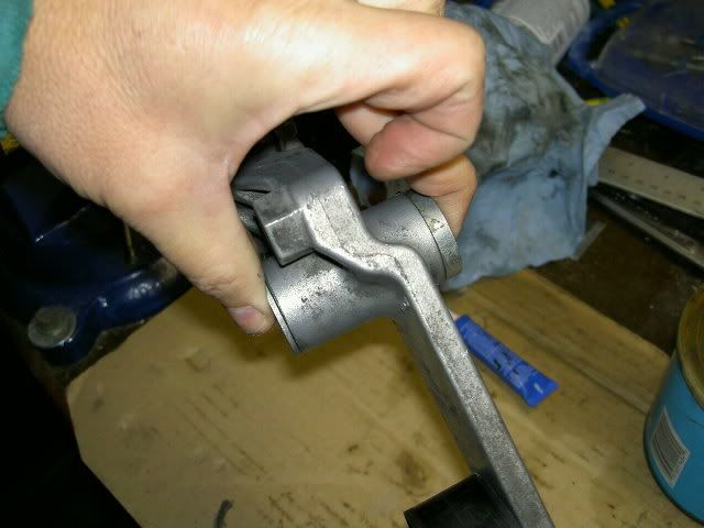

Inspect your work by grabbing the sides of the fulcrum pin and moving the assembly arm. You should now have easy and silent movement and the new pulley should be silent.
