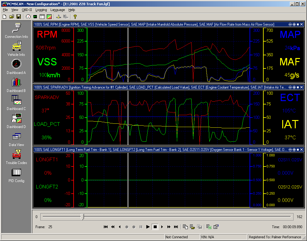

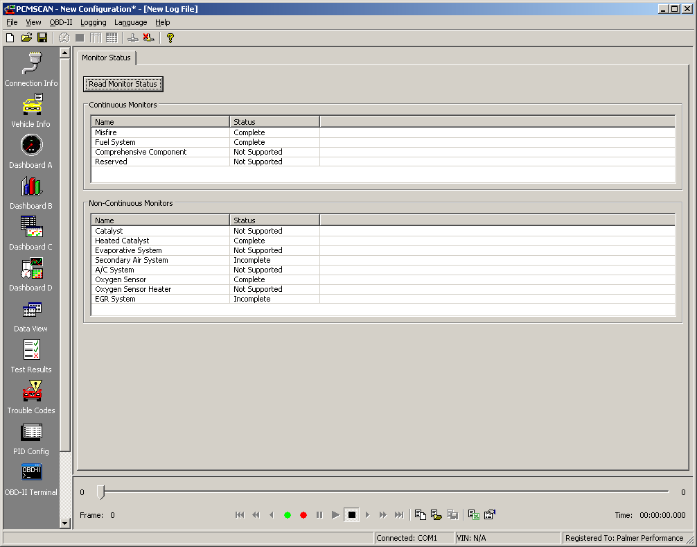

Questa volta introduco io un nuovo programma per la lettura dei dati tramite la porta OBD2... Dopo vari tentativi sono riuscito ad "acquistarlo" ad un prezzo molto scontato (intorno alle 2 carote) e devo dire che ? un bel giocattolino, sicuramente superiore a ScanMaster basic... Il professional, dalla demo, sembra molto meglio, ma non ho avuto il piacere di provarlo...
Torniamo a noi... Il programma ? interamente in Inglese ed ecco alcune info e screenshot!:
PCMSCAN
PCMSCAN Features
Virtual Dashboards

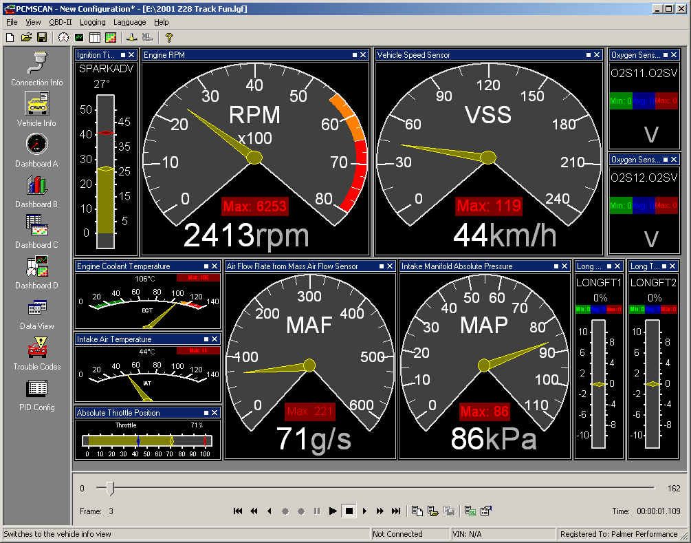

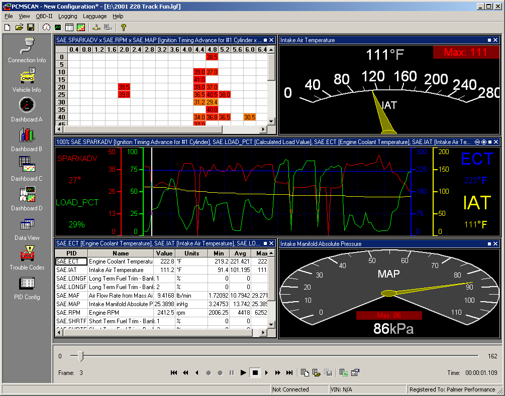

    * Highly configurable realistic looking gauges.
    * Gauges can be moved, resized, and laid out to resemble your own dashboard.
    * Virtual dashboard layouts can be loaded and saved from pre-existing templates or your own custom creations.
    * Gauges can be configured to report the minimum, maximum, and average values of the parameter being monitored.
    * Highly configurable graphs allow simultaneous graphing of up to 8 parameters per graph.

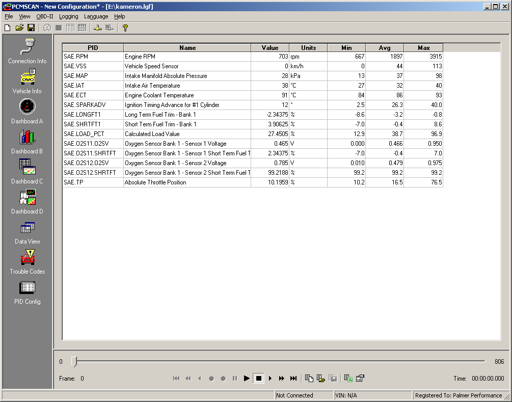

    * Tables can be placed on virtual dashboards and customized to report any parameters you want.
    * Maps can be placed on virtual dashboards and customized to display a full 3D view of any desired parameters.
    * You can set up an unlimited number of gauges, graphs, tables, and maps on your virtual dashboard.

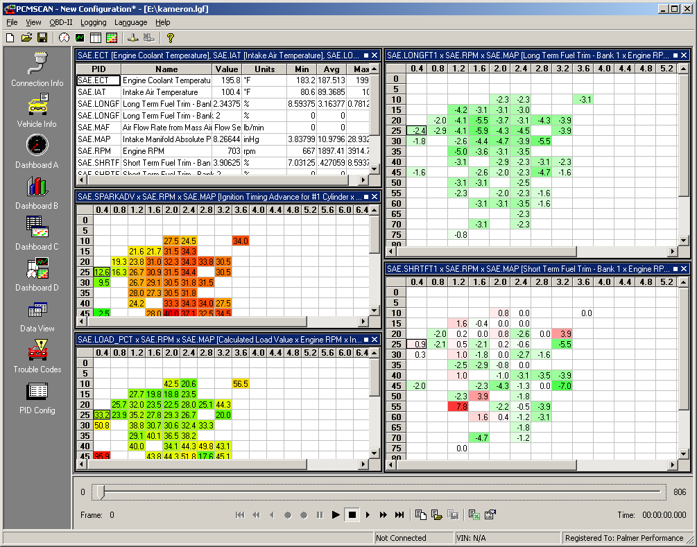

Data Logging
    * Currently supports over 160 generic OBD-II parameters, including O2 sensors.
    * Also supports all aux. input parameters available from the Innovate Motorsports LM-1 Wide Band O2 meter.
    * Also supports the AEM UEGO wide band O2 meter as an aux. input.
    * Also supports the TechEdge wide band O2 meter as an aux. input.
    * You can record and playback log files in real time (1ms logging accuracy).
    * You can save and load your log files for offline analysis.
    * Playback speed can be adjusted to play faster or slower than real time.
    * There are no restrictions on how much data you can log, it is only limited by how fast your OBD-II interface cable can send the data and by how much memory you have in your computer.
    * English and Metric (SI) unit measurement systems supported.

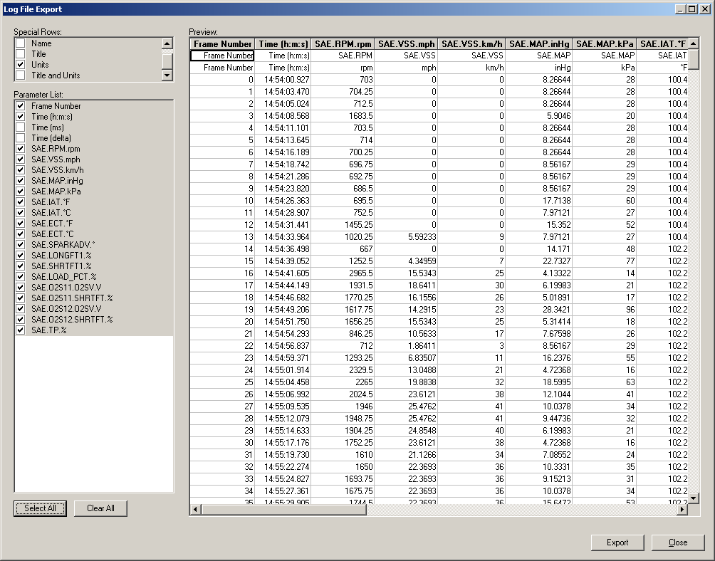

    * Customizable log file data export to .CSV file for easy viewing in other programs like Excel.
    * Export with real-time stamps for easy correlation with external data logs.
    * PIDs can be assigned priorities to speed up the data capture rate.

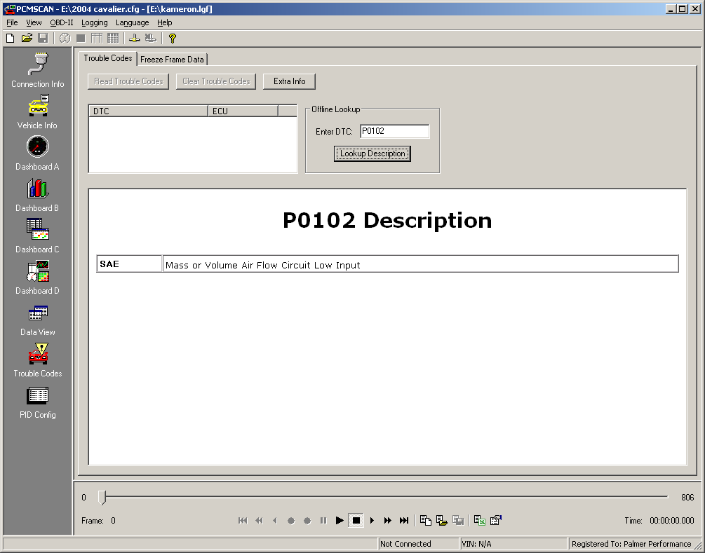

Trouble Codes
    * Read stored and pending Diagnostic Trouble Codes.
    * Clear the Check Engine or Service Engine Soon indicator light.
    * Read and clear stored Freeze Frame data.
    * Look up trouble code descriptions offline, without needing to connect to a vehicle first.
    * Supports over 12,000 generic and manufacturer specific trouble code definitions.

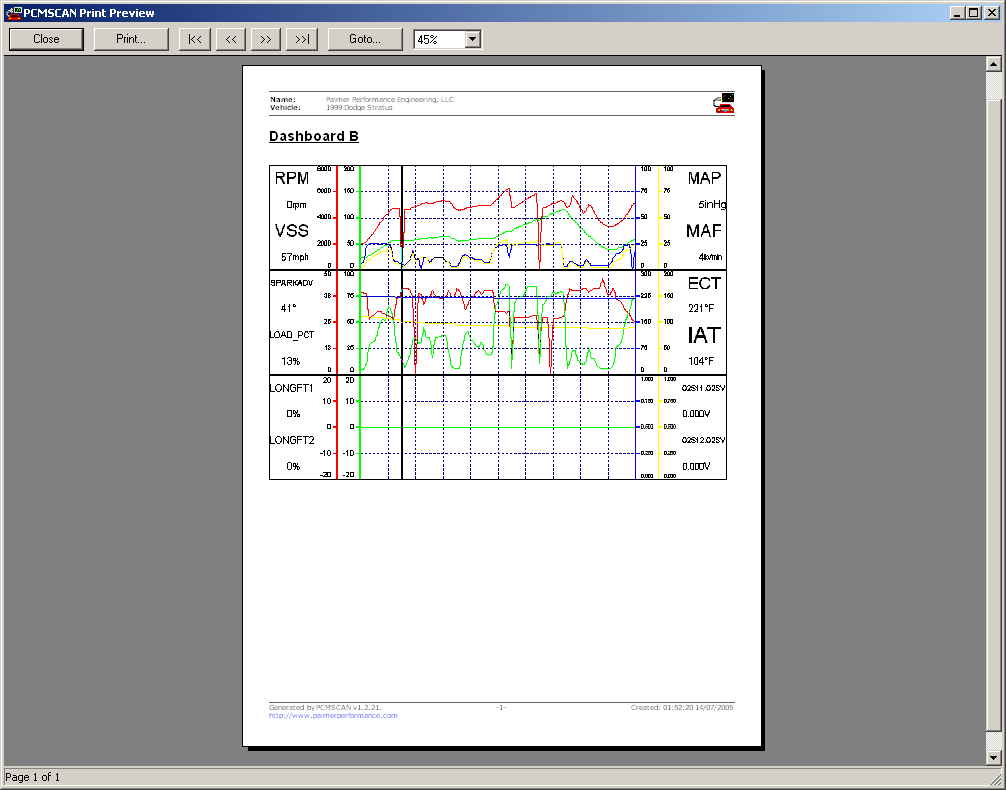

    * Full support for printing and print preview.
    * All of the different views, including the virtual dashboards, support printing/print preview.

Per i profani della lingua inglese, ecco un breve riassunto:
questo simpatico programmino d? la possibilit? di analizzare tutti i dati principali provenineti dalla Obd2 consentendo un completa personalizzazione dei gauges alivello di valori e di ricezione dati. Inoltre se ne può comporre la schermata affiancandoli ai grafici relativi, per esempio, all'airflow o all'air temperature... Altra cosa veramente bella ? il poter monitorare tutti quei valori provenineti dalle sonde Wide band (NB: le celica hanno sonde norrow band che restituiscono valori poco precisi, ad esempio per l'airfuel): ? compatibile con le sonde Innovate Motorsports LM-1 Wide Band O2 meter, AEM UEGO wide band O2 meter e TechEdge wide band O2 meter.
Funzione vera,ente eccezionale ? quella di poter registrare i valori che vengono acquisiti per poi poterseli rivedere anche a Elm staccato, comodamente a casa propria... questo eprmette anche di poter fare confronti tra 2 auto con modifiche differenti o che hanno problemi...
Infine, come la strgrande maggioranza dei programmi di diagnostica, possiede l'elenco della maggior parte degli errori riscontrabili sulla vettura con CEL accesa...
